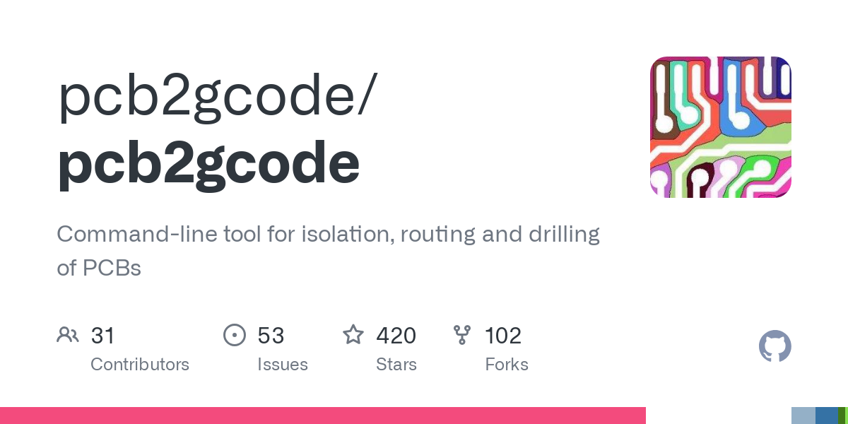

pcb2gcode is a command-line software for the isolation, routing and drilling of PCBs. It takes Gerber files as input and it outputs gcode files, suitable for the milling of PCBs. It also includes an Autoleveller, useful for the automatic dynamic calibration of the milling depth.

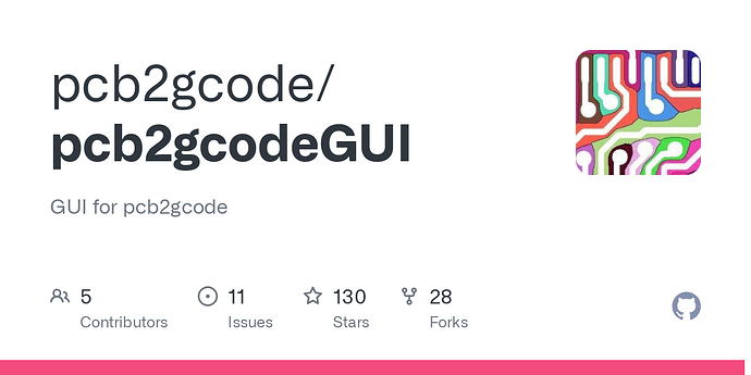

pcb2gcodeGUI, the official GUI for pcb2gcode, is available here.

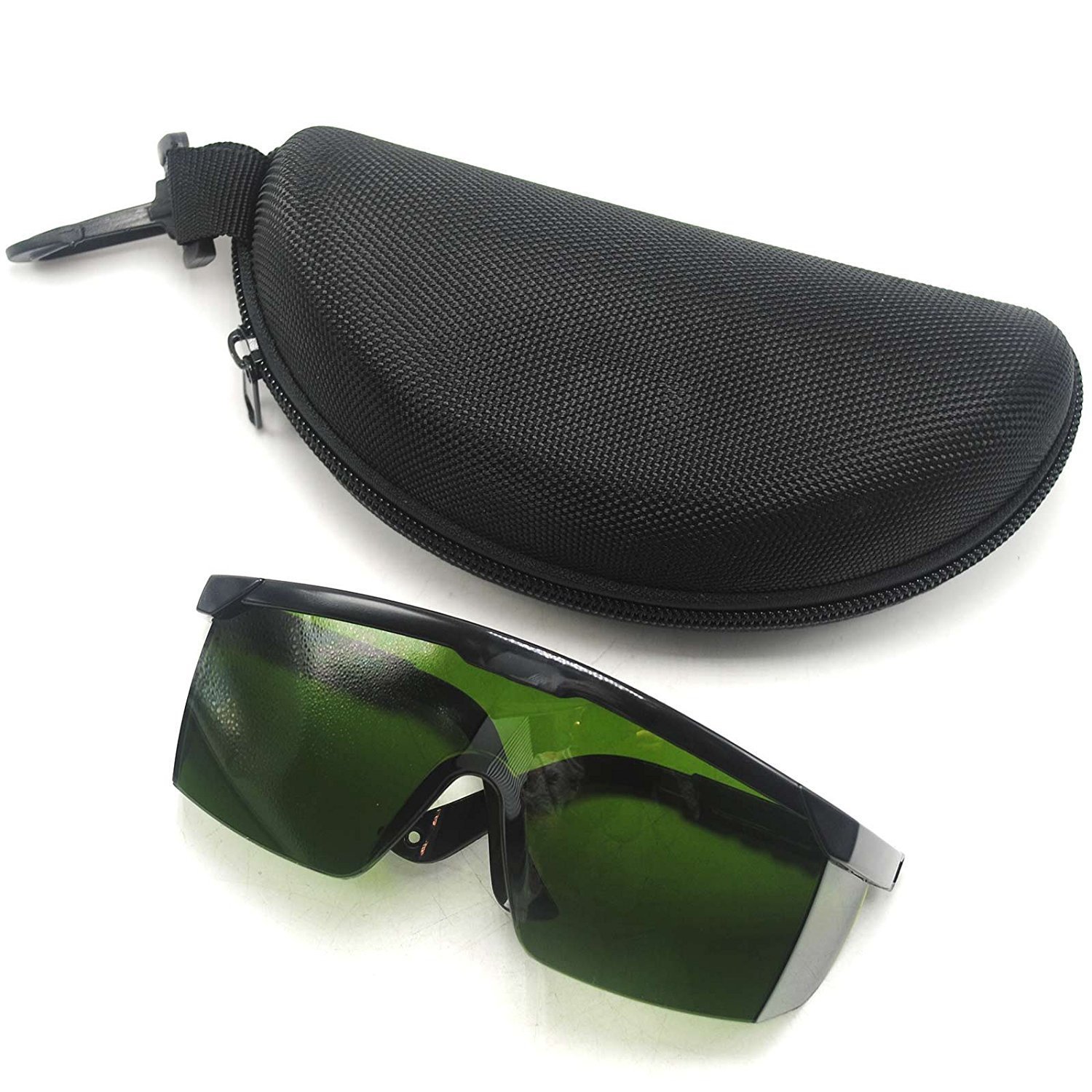

同じ出品者(Top Lasers)から保護眼鏡。
Amazon | 紫色レーザー保護ゴーグル安全メガネレーザーアイプロテクション目の保護 | 保護メガネ | 産業・研究開発用品 通販
